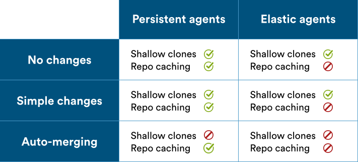

Each time a build runs, your build server clones your repo into the current working directory. As I mentioned before, when Git clones a repo, it clones the repo’s entire history by default. So over time, this operation will naturally take longer and longer. Unless you enable shallow cloning in Bamboo.
Avec des clones superficiels, seul l'instantané actuel de votre dépôt peut faire l'objet d'un pull. Ils peuvent donc être très utiles pour accélérer les builds, notamment lorsque vous travaillez avec des dépôts volumineux et/ou plus anciens.
Git Repos Screenshot
But let’s say your build requires the full repo history – if, for example, one of the steps in your build updates the version number in your POM (or similar), or you’re merging two branches with each build. Both these cases require Bamboo to push changes back to your repo.
As of Git 1.9, simple changes to files (like updating a version number) can be pushed without the entire history present. But merging still requires the repo's history because Git needs to look back and find the common ancestor of the two branches – that’s going to be a problem if your build uses shallow cloning. Which leads me to tip #3.

Note that repo caching only benefits you if you're using agents that persist from build to build. If you create and tear down build agents on EC2 or another cloud provider every time a build runs, repo caching won’t matter because you’ll be working with an empty build directory and will have to pull down a full copy of the repo every time anyway.
Shallow clones plus repo caching, divided by persistent vs. elastic agents, equals an interesting web of factors. Here’s a little matrix to help you strategize.
Persistent agents vs elastic agents screenshot
